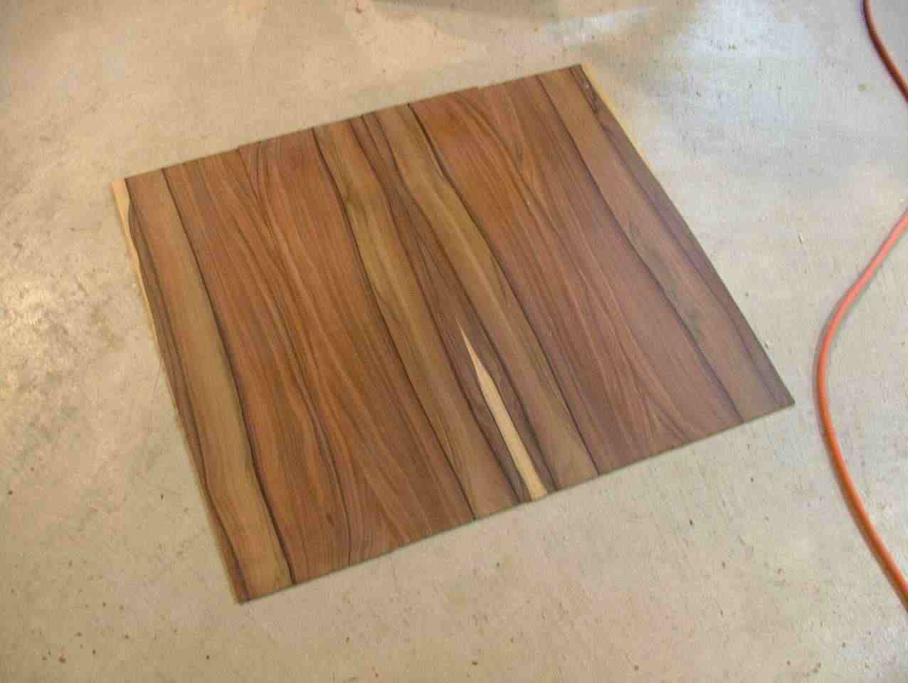

That your just dieing to use? I have had this set of PauFerro (Also from AC Woods) For about 3 years now, and NOBODY will pick it for me to build with! I know I can just use it my self, but its just so purty, I want to save it for that somebody that it just speaks too! Know'wad I mean Vern!

i've never used pau ferro, but have read that it can cause alergic reactions like coco bolo. what was you experience with it?
PostPosted: Thu Jun 02, 2005 7:09 am
That piece looks a little flat sawn tward the edges or is it just run out?
PostPosted: Thu Jun 02, 2005 7:37 am
[QUOTE=MichaelP] That piece looks a little flat sawn tward the edges or is it just run out?[/QUOTE]
I've seen a lot worse used to build some great guitars. Looks like a lovely set to me.

[QUOTE=Bobc] [QUOTE=MichaelP] That piece looks a little flat sawn tward the edges or is it just run out?[/QUOTE]
I've seen a lot worse used to build some great guitars. Looks like a lovely set to me.[/QUOTE]
It looks super where it counts. I think it is just grain movement at the edges

I really like the look of the wood. I've also picked up some nice sets of Pao Ferro/Morado from the Zootman. I've been holding back on using it until I add an additional air filter, same with cocobolo. I wasn't aware of the possible allergic reaction when I purchased it and now think caution is the best approach. I really like the look even though some is more plain than your set (yours looks almost like a brown zircote). It is hard to believe it isn't selling. You can also pick up bridge blanks and fingerboards from LMI.
